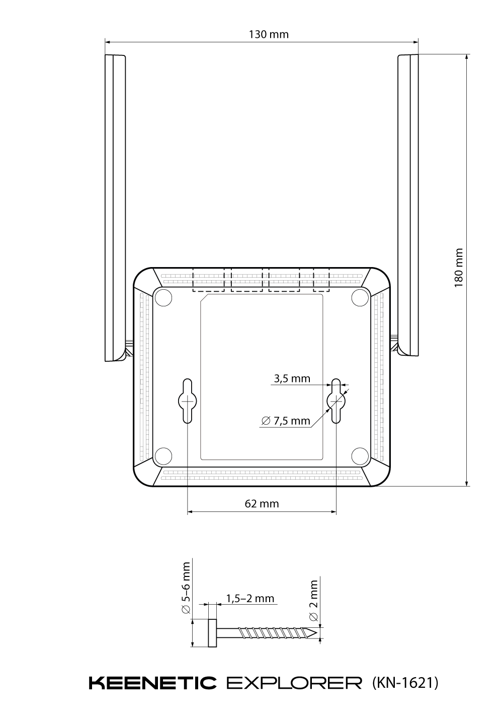

All Keenetic router models have a wall mount option. There are two holes on the back of the case.
Mounting elements (self-tapping screws and wall plugs) are not included with the router.
Information on mounting hole spacing and screw specifications:
Model | Explorer (KN-1621) |
Distance between holes | 62 mm |
Head diameter | 5–6 mm |
Head height | up to 1.5–2 mm |
Thread | 2 mm |
Thread length | at least 20 mm |
