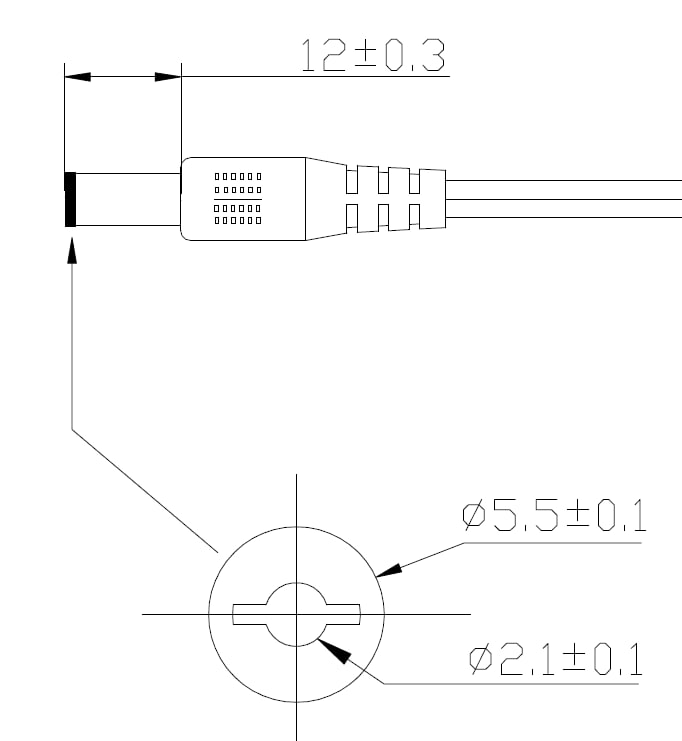

Keenetic routers (KN-xxxx) use the following supplied DC power adapters with the following power jack geometry:
Router Model
Power Adapter
Keenetic Voyager Pro (KN-3510)*
12 V, 1.5 A
* — In addition to an external power supply, the unit can also be powered via PoE.
A power adapter is included with the individual Orbiter/Voyager package, but is not included in the special 4-pack set.
All Keenetic models are powered from 100 - 240V 50/60Hz AC power.
The power adapters have a rectified stabilized output voltage of 9/12V with a DC current not exceeding 3.0A.
