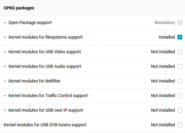

In your Keenetic router, install the required OPKG components. The primary and mandatory one is the Open Package support component.

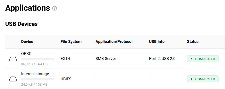

Plug the USB drive with the ext4 file system into the router's USB port. The drive should appear on the Applications page under USB Devices.
Use a file manager to connect to the drive via the network (in Windows, you can use Explorer). In the router's settings, the SMB server application must be enabled in advance to access USB disks that you connect over the network.

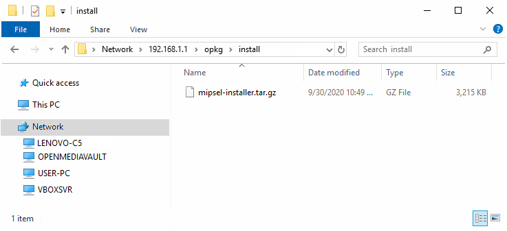

Create an
install
directory in the root of the disk partition where you put the filemipsel-installer.tar.gz

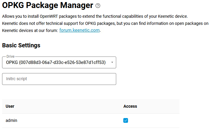

.Go to the OPKG Package Manager page and select the ext4 drive you have prepared in the Drive field.
Click Save.

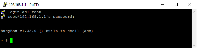

Then go to the router settings using the Secure Shell (SSH) protocol.
To log in, enter:
login as:
root
root@192.168.1.1's password:keenetic

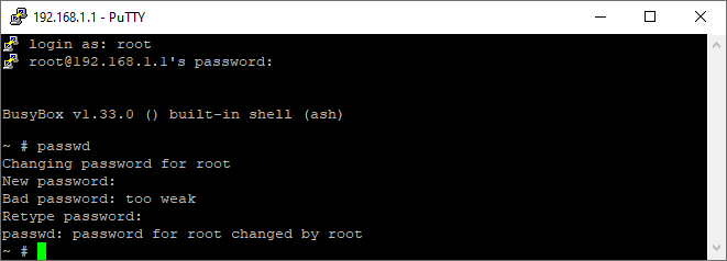

You can set your password. To do this, enter the
passwd
command:New password:
enter your password
Retype password:
confirm the password
passwd
Changing password for root New password: Bad password: too weak Retype password: passwd: password for root changed by rootAfter successful authorization, you will come to the BusyBox () built-in shell (ash). Now you need to update the opkg package by entering the command
