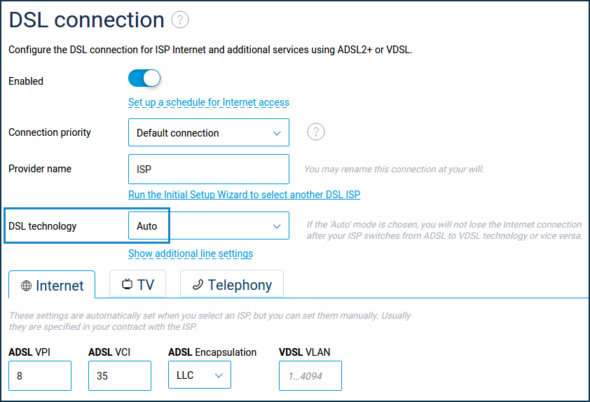

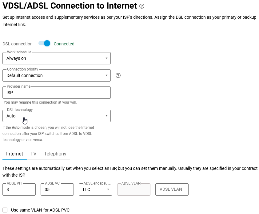

Auto ADSL/VDSL connection mode
Some operators can switch a subscriber from ADSL technology to VDSL (or back), but the device will continue operating when the automatic mode is enabled.
In the web interface on the DSL Connection page, you can set up both ADSL and VDSL connections separately at the same time. Depending on the line type, the modem connects in ADSL or VDSL mode and uses the setting corresponding to the connection mode.
