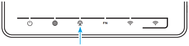

Mobile Network LED indicator statuses
Keenetic Runner 4G (KN-2211) router has the Mobile Network LTE-LED-01.png indicator on the housing.
The indicator shows the connection status and signal strength of the cellular network:
