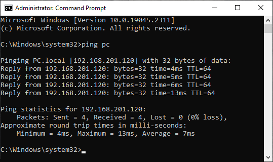

Afterwards, check the automatic recognition of network host names on the router's LAN using the ping command.

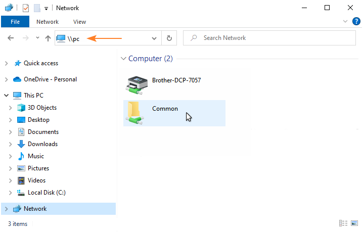

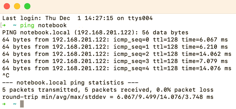

Here is an example. Suppose you have a PC and a laptop on your network which use the hostname 'PC' and 'Notebook' respectively (e.g. in your network, it could be a server with the hostname 'SERVER'). Let's activate the command mentioned above in the router and reboot it. From the laptop, run the ping pc command to ping the computer.
By typing \\pc in the address bar of Windows Explorer, you will see a list of shared network resources.
Now from the computer, run ping notebook.
As we can see, hostname and IP address mapping is automatically triggered.

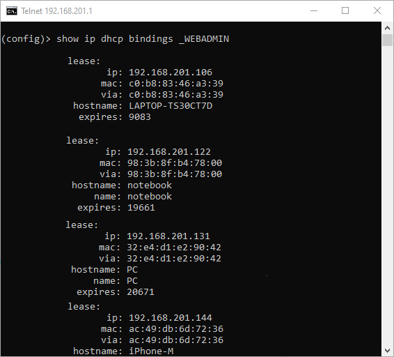

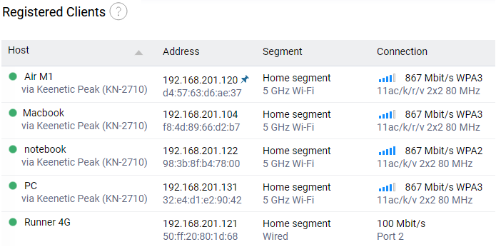

Keenetic will access the hostname parameter. In the web interface on the Client Lists page, you can set and change another parameter — name. In the router CLI, a command show ip dhcp bindings _WEBADMIN shows that these are two different fields:
When a host is registered in Client Lists, the hostname field is copied to name, which is the same in this case. But as soon as the user changes hostname on the Client Lists page, this change is written to name field, and there will be no mapping of the domain name and IP address by this name. You will need to add another DNS record to the desired host in the CLI using the ip host command or change the hostname parameter directly on the host.
