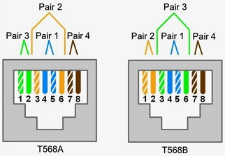

The twisted pairs A, B, C, D is equivalent to 1, 2, 3, 4:
