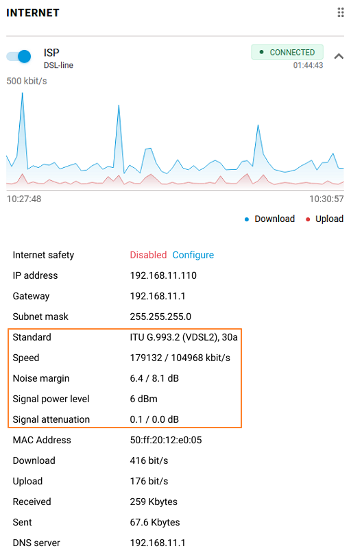

VDSL line parameters
In the web interface of Keenetic Hero DSL (KN-2410) on the System dashboard page in the Internet information panel, you can see the status of the VDSL connection, its current parameters, and perform the initial diagnostics.
The main technical characteristics of the established VDSL connection are shown in the parameters Standard, Speed, Noise margin, Signal power level and Signal attenuation. The VDSL2 uses the same parameters as ADSL2+ technology. Below are descriptions of the main parameters and characteristics of the physical communication channel (leased line).

Speed is the channel rate of the connection to the DSLAM. Two speeds are displayed: the first number is the receiving speed, i.e. the speed to the subscriber (DS / downstream), and the second number is the transmission speed, i.e. from the subscriber (US / upstream).

Noise margin is used as a line condition assessment criterion and determines the minimum limit at which the signal level is above the noise level. Noise margin is a good indication of the line quality. The transmission noise margin limit is 6 dB
, a value below which a VDSL connection is not guaranteed at all. If the noise margin is below 6 dB
, frequent interruptions may occur.
If the noise margin is greater than 10 dB
, the line has good parameters for data transmission. The higher the noise margin, the better the line quality. The Noise margin parameter value should be 6 dB
or higher. It can reach up to 30 dB
if a short line is used.
The Noise margin field displays two values
— the first number for the direction to the subscriber (DS) and the second number for the direction from the subscriber (US).
The value of Noise margin [dB
up to
6 dB
— a low-quality line, there are synchronization problems;7 dB
to10 dB
— failures may occur;11 dB
to20 dB
— good line, no synchronization problems;21 dB
to28 dB
— a very good line;29 dB
and above — an excellent line.

Signal power level (Output Power) — shows the output power of the signal as the modem is synchronized with the DSLAM. Typically, the output power when sending data is approximately 10 dBm
. This value may be lower due to signal power loss.
Signal attenuation — shows signal attenuation in the line as the modem synchronizes with the DSLAM (this parameter should be less than 45 dB
). The attenuation depends on the length of cable between the VDSL modem and DSLAM. The higher the value of this parameter, the lower the line quality and therefore, the lower the transmit/receive rate. Optimal values should be between 5 dB
and 30 dB
(for excellent and good line). An attenuation value of 45 dB
and above means that the line is not suitable for VDSL to use.
The Signal attenuation field displays two values
