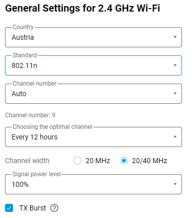

Choose the 802.11gn or 802.11n standard in the 2.4 GHz Wi-Fi (the main idea is to remove 802.11b and prohibit devices from connecting by to this standard), select to search for the optimal channel every
12
or24
hours, or manually set the channel number, set the signal strength to100%
.How to select the channel to operate the wireless network is shown in the instruction How do I scan a Wi-Fi network and determine the freest channel?

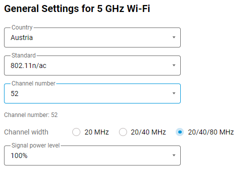

In the 5 GHz Wi-Fi network settings, manually set the channel number from
36
to64
. Some devices may not work with channels in the upper band (above 140
). For more information, see the article Your mobile device can't see the 5 GHz Wi-Fi network?Note
There is a nuance on Keenetic devices that support
160 MHz
channel width. If you don't have devices that support this width, it's better to exclude160 MHz
and use the20/40/80
option instead. If you need to use a160 MHz
width, you should manually set channel 36, as this width implies that the client occupies the entire 36-64 channel block.It also makes sense to disable the power saving options (power saving mode) of the Wi-Fi module on mobile devices.
