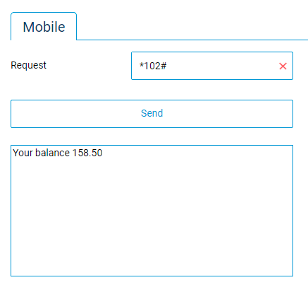

The USSD page is added to the web interface. The page is available when supported QMI-type modem is attached to the USB port. Issue USSD codes after mobile connection is established to request specific information or subscribe to mobile operator's services. For instance, you can get account balance information, change the tariff and so on. [NDW-1522]

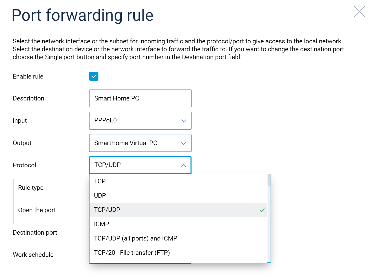

The port forwarding rule setting in the web interface is restored. The rule for the combination of TCP and UDP protocols can now be properly added on the Port forwarding page in the web interface. [NDW-1436]

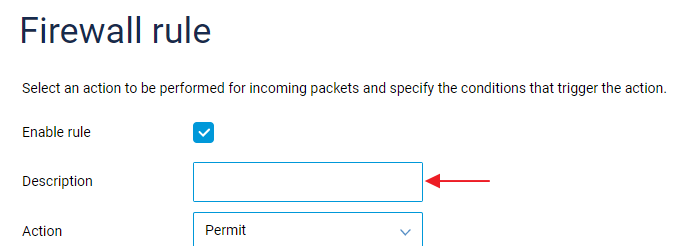

Rules enrichment: A description field has been added to the firewall rules control. [NDM-939, NDW-1302]

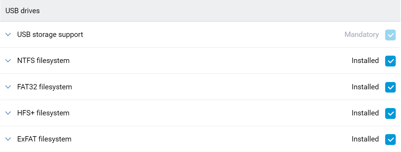

Finer control: The Ext filesystem support has been unbundled as a separate component. If you are not using Ext filesystem on your attached USB-disks, removing the component helps to save memory for other useful options and applications available in KeeneticOS. [NDM-965]
Configuration enriched: The Port forwarding rule form now has dual TCP/UDP protocol options for your greater convenience in configuring access to the services on your local network from the Internet. [NDW-1241, NDM-909]

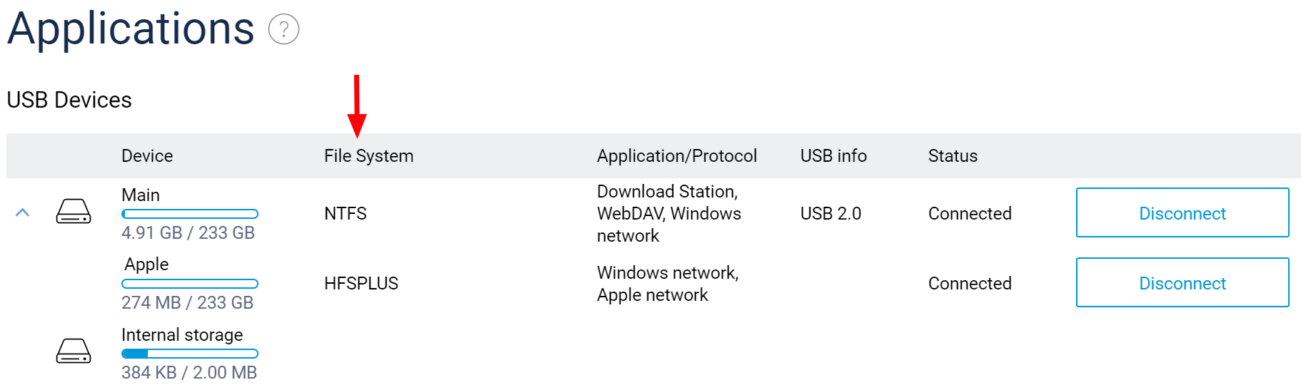

Better USB visibility: The Usb Devices table in the Applications section now shows the file systems of connected USB-drives. KeeneticOS supports the NTFS, FAT32, Ext, HFS+ and ExFAT file systems via the installation of the corresponding system component in the Management > System Settings section. [NDW-1233]

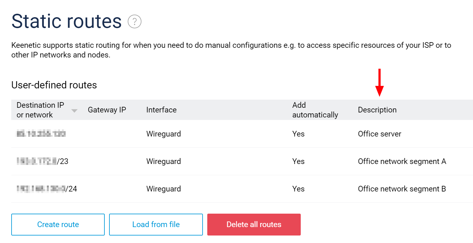

Network rules note facility: In the Network Rules > Routing section there is now a way to describe the purpose of a particular static route entry. A Description field is added to the Static route parameters form and User-defined routes table. Further, for your greater convenience, you can sort the table by clicking any column header row, including Description. [NDM-911, NDW-1231]

Incorrect free storage space calculation in the Media Server application is fixed. [NDM-684]
Incorrect display of 4G/3G signal quality information for the LTE Cat4 Huawei H3372 modem in HiLink mode is fixed. [NDM-739]
Mounting of disk partitions with UTF-8 encoding in the label is fixed. [NDM-729]
