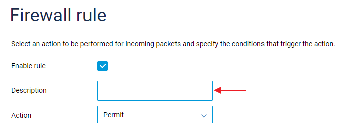

Rules enrichment: A description field has been added to the firewall rules control. [NDMS-939, NDW-1302]

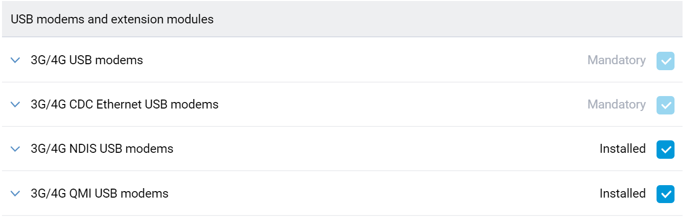

LTE modules / IoT: The Quectel EG12 and EM12 LTE Advanced category 12 modules are now supported. [NDMS-928]
Please install the 3G/4G QMI USB modems system component in the Management > System Settings section before connecting the modem.

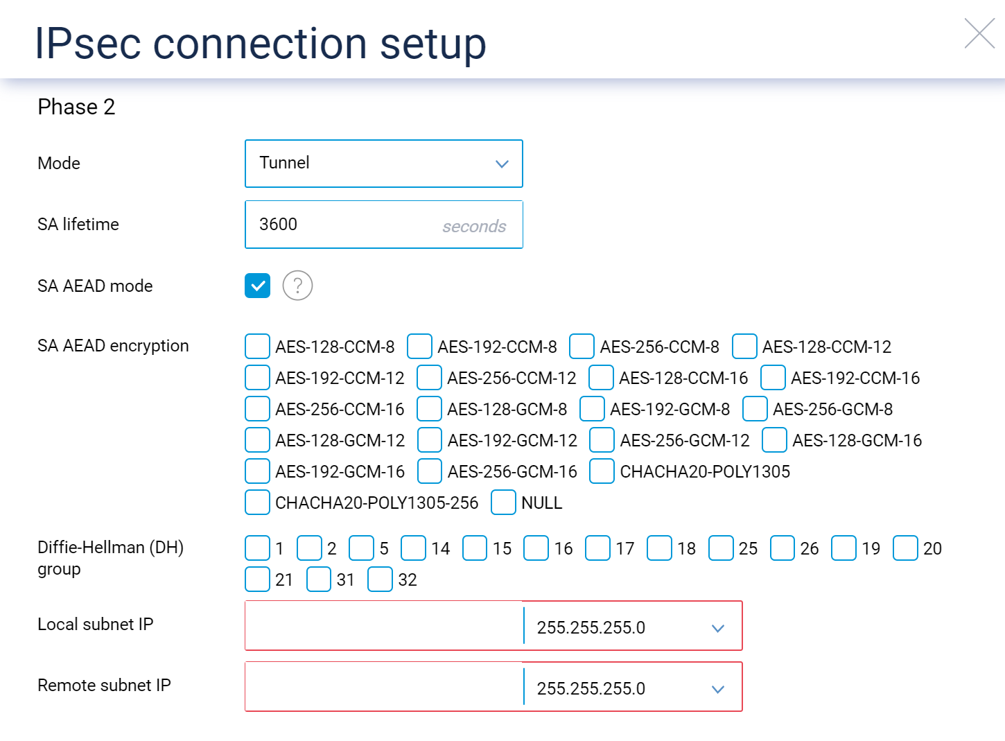

Better IPSec security: The IPsec VPN system component now has the latest and greatest security options for making your IPsec VPN tunelling as safe as possible. IPsec connections now support:
the AES-CTR encryption algorithm;
the AES-CCM, AES-GCM and CHACHA20-POLY1305 combined-mode/AEAD cipher algorithms;
new elliptic-curve Diffie–Hellman groups, including
ECP 192/256/384/521
andx25519/x448
[WEB-4059]

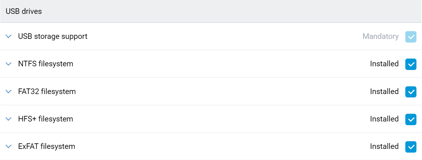

The exFAT file system is now supported. This file system was introduced by Microsoft and optimized for large volume USB flash drives. [NDMS-701]

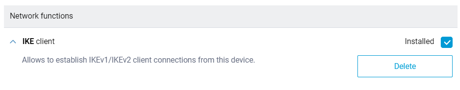

The new IKEv1 IPsec VPN connection client is now available. Go to the VPN connections section of the Other connections menu to configure it. [NDW-1025]

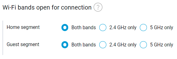

The new Wi‑Fi bands open for connection option is implemented. This configuration option allows the limiting of the connection of a dual band wi-fi client to a particular wireless band only: 2.4 or 5 GHz. The setting works for both a standalone device and a Wi‑Fi system with multiple nodes. [NDW-987]

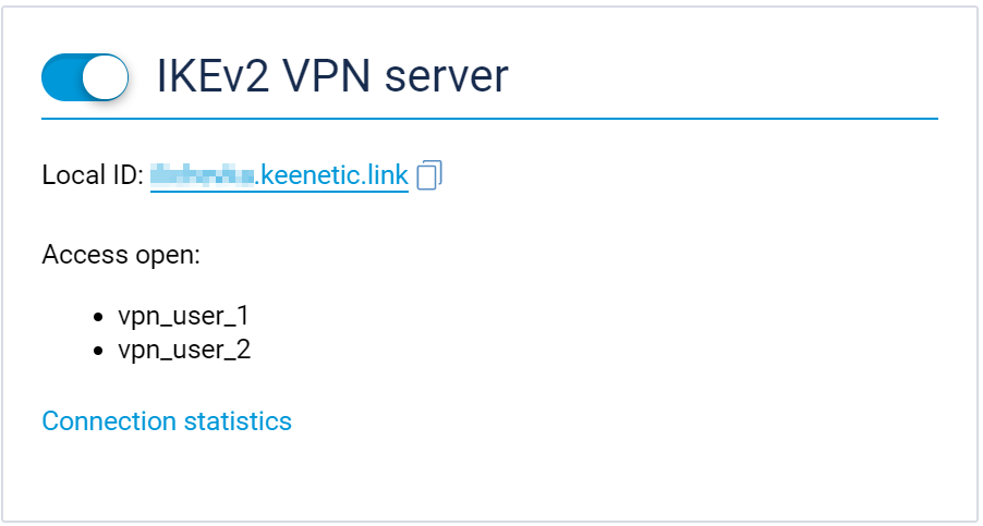

The new IPsec IKEv2 Virtual-IP VPN server, using a SSL-certificate, is now available. [NDMS-703]
The IPsec IKEv2 Virtual-IP VPN server allows authorized users to connect to your home network resources over the Internet, using a secure and robust tunneling protocol.
The IKEv2 client is available out-of-the-box in modern releases of Windows, MacOS and iOS operating systems, and most Linux distributions.

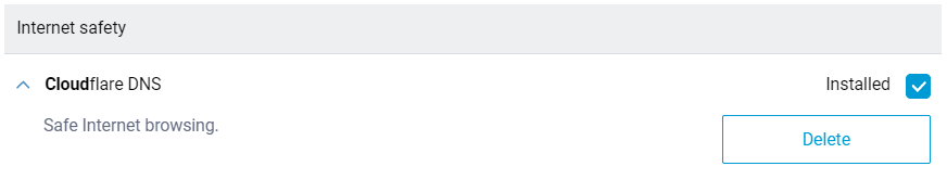

Support for Cloudflare DNS content filtering service is implemented in the Command Line Interface (CLI). There are three levels of protection:
standard
,malware
,family
. [NDMS-617]cloudflare-dns check-availability
cloudflare-dns enable
show cloudflare-dns profiles

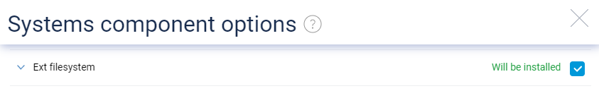

Finer control: The Ext filesystem support has been unbundled as a separate component. If you are not using Ext filesystem on your attached USB-disks, removing the component helps to save memory for other useful options and applications available in KeeneticOS. [NDMS-965]

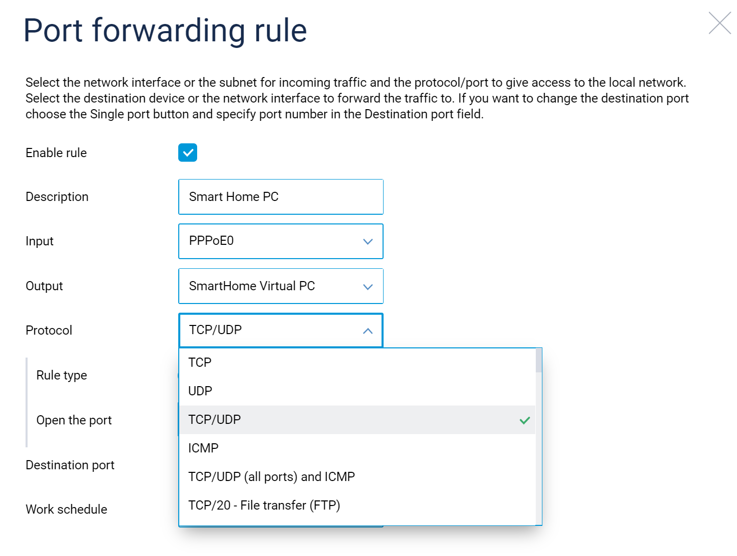

Configuration enriched: The Port forwarding rule form now has dual TCP/UDP protocol options for your greater convenience in configuring access to the services on your local network from the Internet. [NDW-1241, NDMS-909]

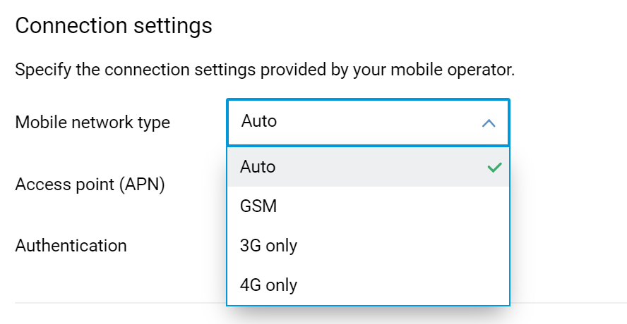

Configuration enriched: 4G USB modems featuring the
UsbLte
type interface now have a Mobile network type selector among their configuration options. Such manual options are useful to prevent modem software from re-assessing and changing network type on their own over a prolonged period online. [NDW-1284]Interface update: The Download Station application now has version 1.6.0 of the Transmission WEB Control interface. [NDMS-949]

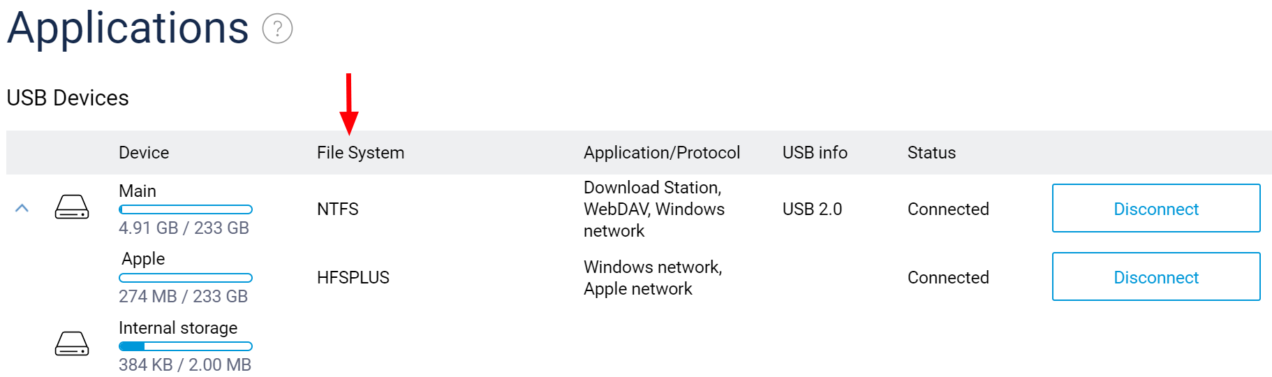

Better USB visibility: The Usb Devices table in the Applications section now shows the file systems of connected USB-drives. KeeneticOS supports the NTFS, FAT32, Ext, HFS+ and ExFAT file systems via the installation of the corresponding system component in the Management > System Settings section. [NDW-1233]

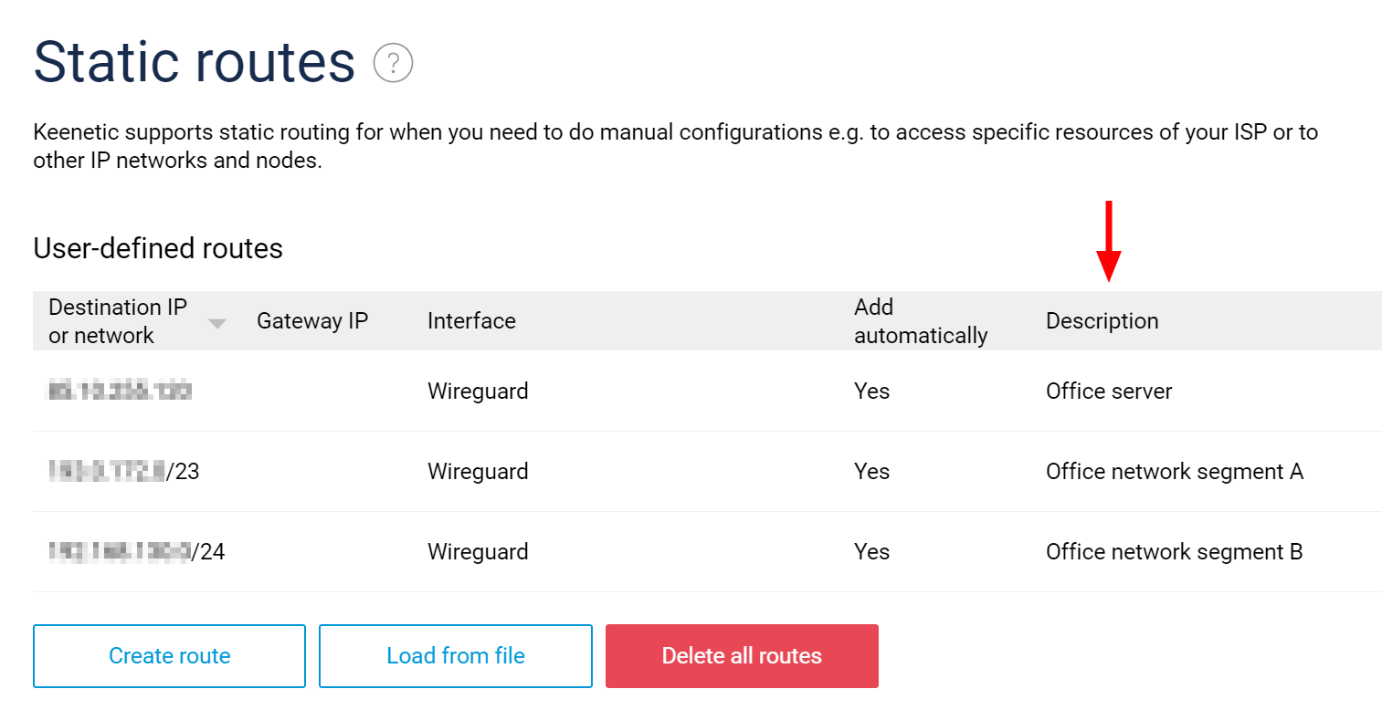

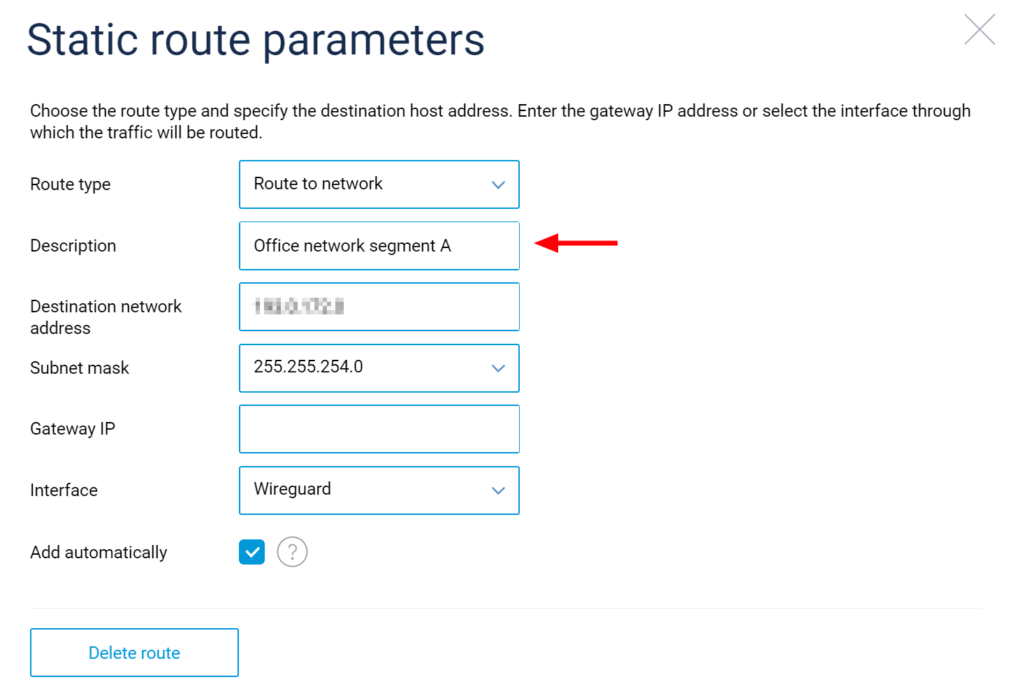

Network rules note facility: In the Network Rules > Routing section there is now a way to describe the purpose of a particular static route entry. A Description field is added to the Static route parameters form and User-defined routes table. Further, for your greater convenience, you can sort the table by clicking any column header row, including Description. [NDMS-911, NDW-1231]
Security efficiency: The IPsec encryption algorithms AES-CTR, AES-CCM and AES-GCM are now partially hardware-accelerated on devices equipped with the AES Crypto Engine.

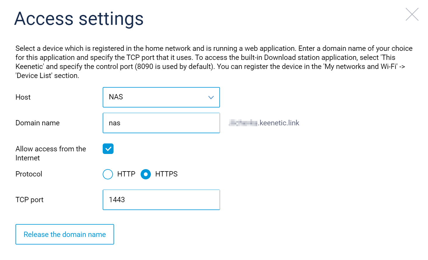

Remote web application access: KeenDNS allows you to enable access from the Internet to web applications running on your network. If your web application runs on HTTPS protocol, the new
https
option will help to set it up. [NDMS-215]ip http proxy {name} upstream (http | https) ({mac} | {ip} | {fqdn}) [{port}]

exFAT file system support backported from Linux Kernel 5.8.

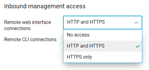

The Remote web interface connections setting from the Users and access management section is now propagated from the Wi‑Fi system controller to all extenders for better remote management control. [NDMS-727]
The Cloudflare DNS internet filtering service is added to the Web Interface. The user can select Service > Cloudflare DNS protection policy on the Internet safety page for each registered host, and Default policy for unregistered hosts. [NDW-971]
Connection statistics for the IPsec Virtual-IP VPN server are implemented, with traffic and time accounting for each incoming VPN connection. [NDMS-685]

An IPsec performance degradation issue introduced with the addition of ESP ALG was fixed. [NDMS-897]

The QMI interface for 4G/3G USB modems system component now works properly with certain operator branded Huawei E392 modems. [NDMS-758]
