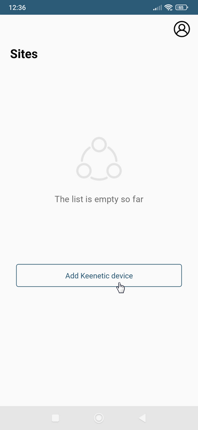

  5. Launch the app, log in to your Keenetic Account or create one if you don't have it. Then, on the Sites screen, tap Add Keenetic device.
    If you are connected to your router's network, the app automatically searches it for Keenetic devices.
    Tap on the detected device.

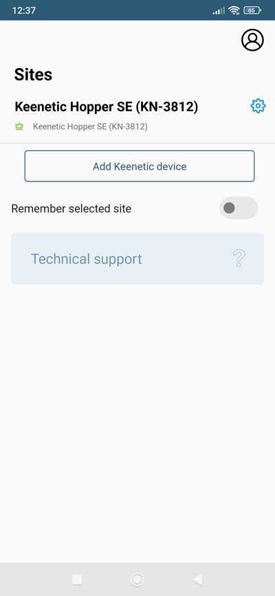

    Use the router administrator name (admin) and password, as in the web interface. Then tap Add.
    By default, no administrator password is set in Keenetic routers. A user must set it during the initial setup. If you do not know or have forgotten the administrator password, use the Reset button on the router to reset it to factory settings.
    If the connection were successful, the router would be added to the app.
