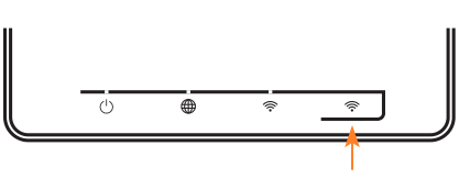

All Keenetic routers have a special button wifi-button-00.png on the case that is preconfigured for Wi-Fi network control.
Pressing this button carries out two operations:
  1. Switching the Wi-Fi network off/on.
    Turning off Wi-Fi on the router turns off the corresponding Wi-Fi network LED on the router, and when searching for available networks on clients, no Wi-Fi router network is present.
  2. Starts a WPS (secure connection to the router without a client-side password) connection.
    Allows you to quickly connect new clients (smartphones, tablets, laptops, TVs, media centres) with WPS-compliant operating systems to the Wi-Fi network. You can also use WPS to connect additional repeaters via Wi-Fi to the main router, without entering a password.
For devices that only have a 2.4 GHz Wi-Fi access point:
  • Pressing it once — starts a fast WPS connection
  • Pressing and holding for 3 seconds — turns the Wi-Fi on or off
For devices with a dual-band Wi-Fi access point (2.4 GHz and 5 GHz):
  • Pressing it once — starts a fast WPS connection on the 2.4 GHz network
  • Pressing twice — starts a fast WPS connection on a 5 GHz network
