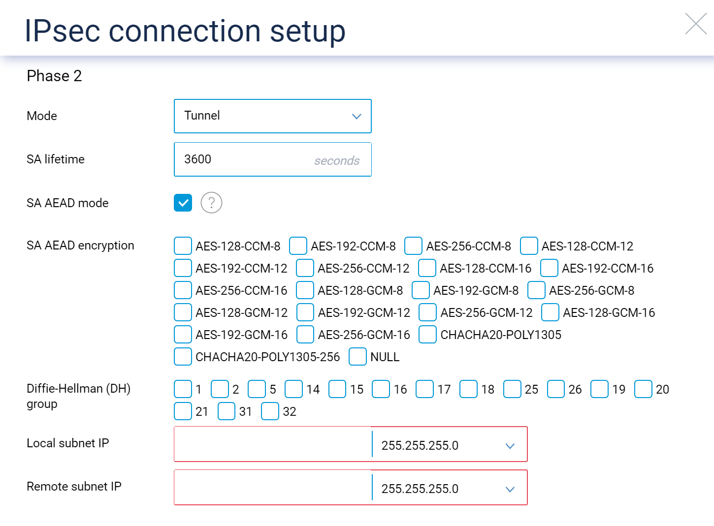

Better IPSec security: The IPsec VPN system component now has the latest and greatest security options for making your IPsec VPN tunelling as safe as possible. IPsec connections now support:
the AES-CTR encryption algorithm;
the AES-CCM, AES-GCM and CHACHA20-POLY1305 combined-mode/AEAD cipher algorithms;
new elliptic-curve Diffie–Hellman groups, including
ECP 192/256/384/521andx25519/x448.

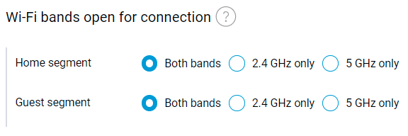

The new Wi‑Fi bands open for connection option is implemented. This configuration option allows the limiting of the connection of a dual band wi-fi client to a particular wireless band only: 2.4 or 5 GHz. The setting works for both a standalone device and a Wi‑Fi system with multiple nodes. [NDW-987]

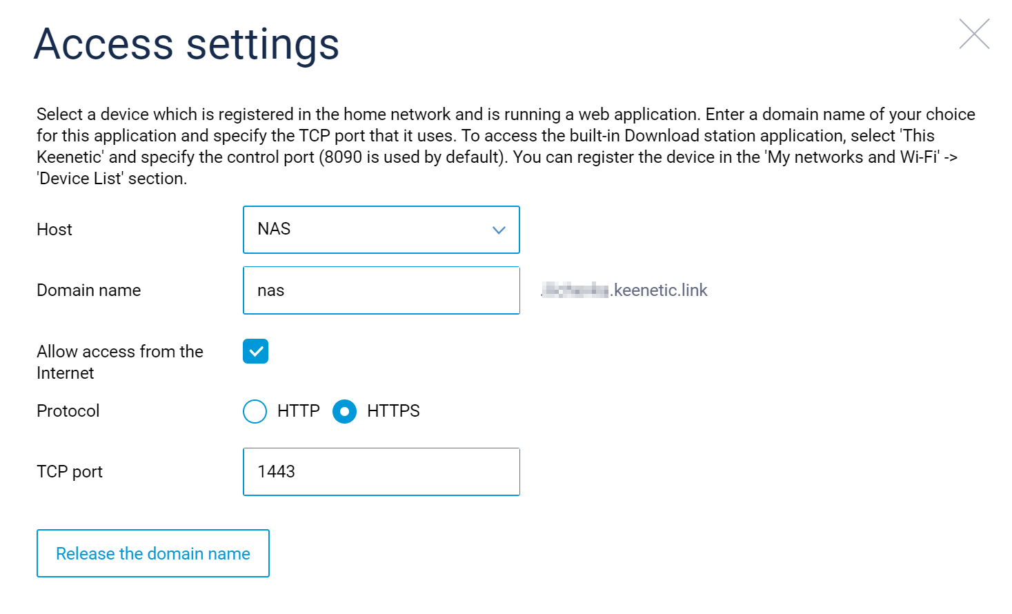

Major security upgrade: Access from the Internet to web applications running on a home network via your registered KeenDNS domain name has been given a substantial security upgrade. If your application runs the HTTPS protocol, you can now select this protocol type in the configuration settings. Most importantly, the Allow access from the Internet configuration option is now independent from any decision you might make to allow remote access to the Web Interface of your Keenetic itself, as configured at the Management > Users and access > Remote access page. [NDM-927, NDM-215, NDW-1242, NDW-1237]
ip http proxy {name} security-level (public | private)ip http proxy {name} upstream (http | https) (‹mac› | ‹ip› | ‹fqdn›) [‹port›]

Security efficiency: The IPsec encryption algorithms AES-CTR, AES-CCM and AES-GCM are now partially hardware-accelerated on devices equipped with the AES Crypto Engine.

Remote web application access: KeenDNS allows you to enable access from the Internet to web applications running on your network. If your web application runs on HTTPS protocol, the new
httpsoption will help to set it up. [NDM-215]ip http proxy {name} upstream (http | https) ({mac} | {ip} | {fqdn}) [{port}]

The removal of the restriction on open wireless bands is now working properly. Selecting back the Both bands setting restores the default behaviour. [NDM-763, NDM-866]
